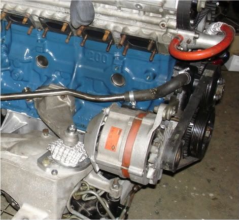

    After some info if anyone can be kind enough to shed some light,
    I need to get an alternator for my engine and i am after a 90amp version to suit the 2wd type bracket set up but i do not know any part numbers etc as i believe some are only 70amp?
    This is the type i am after
    Anybody know the correct part number for the 90amp version?

    its a std bocsh... cossy have 90 amp Stock, same With the Scorpios...

      I read some of the rally boys fit New Holland TM alternators. That's what I'm going to try and fit its 120 amp.
        you can use any bosch With the corect "feet" and tension eye on right place...
        you can also change the inside(dont know what its called in English) to higher amp...

          Here are some pics of alternators of different types on cossies, it may help out.
                90 amp one will be marginal if the car has three fuel pumps. The one I do (see Ossie Cossies pics) is 145amp.

                    Mike - Martin Hadland run a 90amp one on his escos with electric power steering, gearbox and diff coolers, twin pumps etc and never had any issues so should be ok,
                    I've got twin pumps and electric power steering vein the main things,
